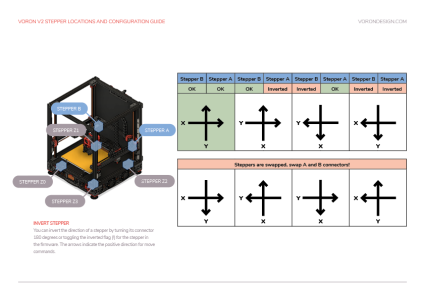

I just finish building a Voron2.4r with a Octopus Pro and with a canbus and a tap. But i have a problem with the X and Y.
When i home the X axis the machine runs to the Y and when i want to home the Y axis he runs to the X axis.
I can not find what to change so it wil work on a normal way
Is there somebody who knows what to do, i already out of option's
I already changed to motors from A to B and from B to A bus this made not changes.
Here are the settings in printer.cfg

You probably have the motors switched. You can rewire them or just change the config and remember your motors are wired backwards. Since it looks like you've already done this, play around with the dir pin inversions (the ! in front means it's inverted) and see if you can get a configuration that works. Have your finger over the e-stop or power switch, of course.
See the diagrams here to help you guess which need to be inverted: https://docs.vorondesign.com/build/startup/
