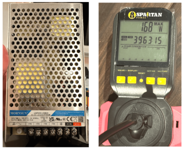

    If you have a Mornsun 200w PSU then change it to Meanwell brand. Your symptoms sound identical to mine.
  • E
    erik.zweigle replied to the thread MCU Timeout on connect.
    I removed the 200W Mornsun PSU and installed a 350W Meanwell PSU. I also attached a power meter between the wall and power cord so I...
