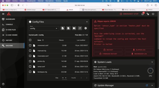

good mornig i have a error in my machine i am new in voron, i have a 2.4 350x350x350 please i need help i am from costa rica can´t find help here thank you so much
You need to go through the config file. There are a number of places in the file where you are expected to fill in specific information about your build. There is some information on the subject here
