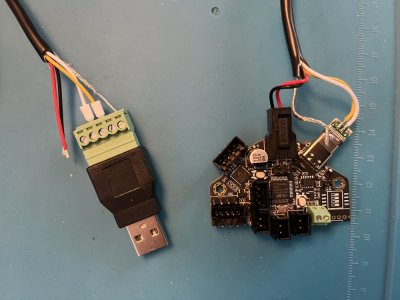

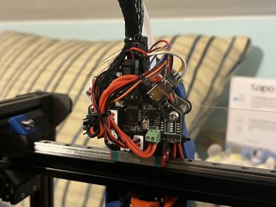

i ran this board on my v0 for a quite some time and it was great, it does exactly what you said in combining the 24v/GND with the USB signal wires with a small breakout board i really liked it. made flashing, updating really easy. i wish more CAN boards would enable this option using dip switches or something along those lines so you COULD run it as USB or CAN depending on what you want.
The way you have setup with the 6 conductor cable on yours seems to be a decent idea as well with the little USB breakout plugged in
