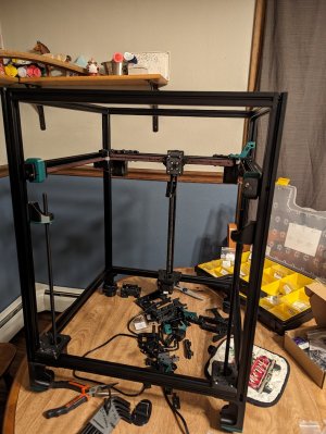

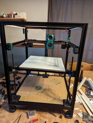

My Voron: LDO Trident 300 (VT.1054)

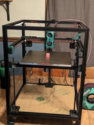

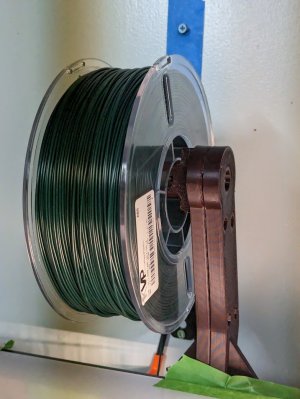

Print failure when trying to print yesterday led to finding this:
You called it.
Dunno if its ABS in general or the KVP ABS in particular, but it doesn't want to stay on the spool as nicely as the PLA I've used before has.

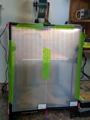

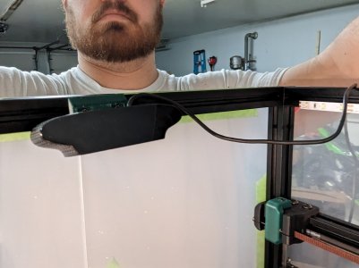

Current webcam does NOT have a great field of view, so I've got one advertised to be wider coming, actually 2 of them, to better monitor the status remotely. Because the C920 looks like this and that just ain't gonna cut it.

Sorry to hear of the failure. Hopefully it didn't cause the spool to partially unwind as well!
Might be the angle of the photo, but did you insert PTFE tubing into the spool holder? It's mentioned on page 314 of the Voron Trident manual, and can also help with things feeding smoothely. My spools flop around a bit on my holder, but that's partially because I have the extended width one for larger spools (I like Replitech's PLA, and theirs come on wider spools that hold 600 meters of filament, so about 1.82kg for PLA)

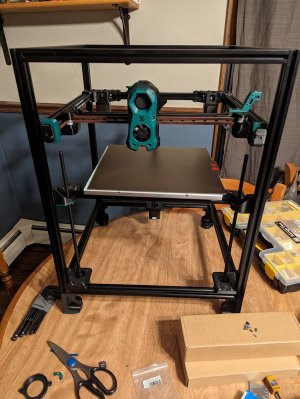

So immediately after I took that screenshot of the webcam the print failed with layer shift. And every print since then has failed the same way. Something went wrong with the printer mechanics.
On Saturday I moved it back inside. And it refused to boot completely.
I hate Raspberry PIs, they seem to corrupt super easily. But at least I have a few of them lying around. Reinstalled raspbian and mainsail and etc on a new microSD card. Grabbed the printer configs from the old card... and it booted fine. *whew*. Everything was good again, except it still fails with the layer shift. Did the belt tension stuff again, double-checked the belt path, etc. No change. Welp. There was also a panic moment when I thought the X/Y front idlers were cracked, but I got that figured out pretty quickly that they are 2 pieces and just not matched perfectly.

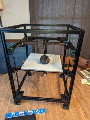

One of my regrets on this build has been not doing a thorough cleaning on the linear rails when they arrived. So.... time to fix that. Tonight I tore the whole X/Y motion system apart. Pulled the rails off, and they are currently soaking in mineral spirits with quality lube waiting for them. I'll let them soak until tomorrow after work, and then lube and re-assemble. It'll be a pain, but it'll also be a better printer. I'll do the Z rails next.
I did order and receive a new camera, so I'll check the FOV on that one and maybe order another. It was cheap.

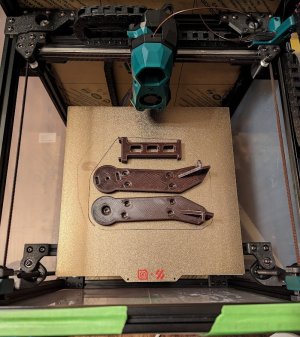

Before all this I did get the door hinges printed, some of the exhaust stuff printed. I like the doors, but these are the VHB tape version, so I need to reprint the bolted version for better stability. Made a list of things to print once its back together, so I'll be working through that list. Eventually.

Pulled the rails out of the bath and reassembled.
Pulled each of the rails off individually, greased them, and re-re-assembled. Dropped several bearings out in the process. Even so, they slide much better than before. Ordered bulk replacement 1/16 and 3/32 bearings.
Re-tensioned the belts.
Make a huge filament ball mess with the 0.4 nozzle. Pulled it out and dropped in a 0.8 nozzle. She prints!

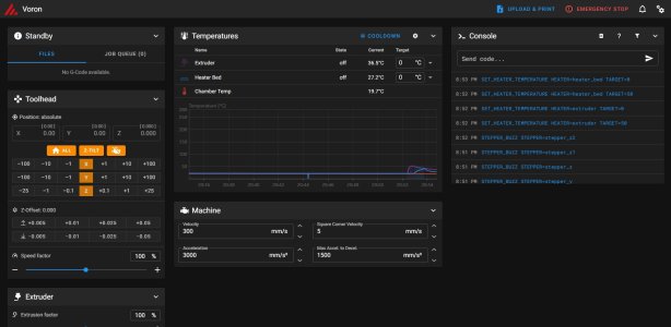

Having issues getting 2 USB cameras to both show. The Logitech works, the amazon camera works, but it seems to be either/or, not both. I want both. And a third, if possible.

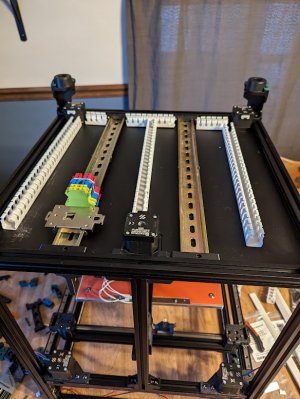

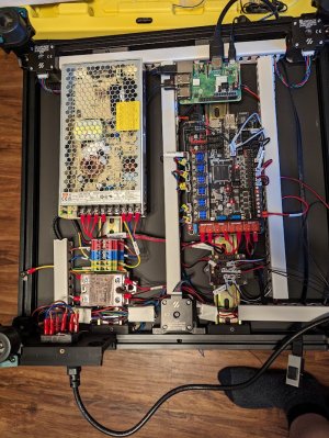

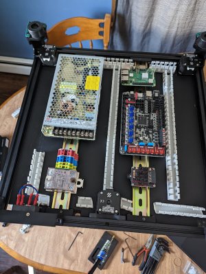

Canbus stuff arrived, and as printing has gotten pretty much plug and play I immediately tore into it again. Glutton for punishment I guess.
Damn, those are some small connections. Got the toolhead board installed, got the can stuff flashed. Turned on power with the can cable connected and got a loud *POP*. Oops. The pi boots, but klipper keeps dying and the toolhead board doesn't light up. I had the USB 5v jumper installed, I think I fried the board. Oops. Im thinking/hoping it's only the 2209 board and not the U2C.
So I ordered a replacement and have to wait for it to arrived. It'll be here soon enough. Need to go through and adjust all the pin assignments. That'll be fun.

I found out what caused the *POP*! Turns out the CAN board does not appreciate getting fed 120vAC instead of 24vDC. Jumper had nothing to do with it. Replaced the board, replaced the U2C for good measure, spent an hour in the CAN discord trying to troubleshoot (green and yellow are not to be confuzelled) and voila, CANbus! Nothing like spending weeks of downtime for what should have been a fairly simple procedure. Light on TAP wouldn't switch away from red, had signal/ground backward on the connector. Maybe wiring really isn't my thing.
She homes, she levels. I'll try re-doing z-offset and some test prints tonight, was almost 11 when I got it this state last night, and my brain was completely fried. Need to blow out dust and get the panels back in place, but at least the end of building and beginning of printing is somewhat in sight. My folks are in town next week, I'd like to be 100% functional before they arrive without having to spend all the time before that working on it. Wife is annoyed enough about the printer as is.

Got the second webcam running, which is nice. Used up so much of my black and accent rolls I ordered more. Finally getting around to printing skirts for the damned thing. Ordered a high flow 1.0 nozzle to go with the 0.6 nozzle, so that's nice. Printing is fast and reliable now.
