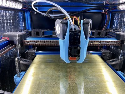

Here is my V1.8 running with umbilical for a year now without issues. I use a Keybak to tension the umbilical cord to keep it from flopping around.
I had no piece of nylon filament around and didn't want to buy an expensive spool of 2.85mm that I would take <1m out of to use this way, so I put a length of 4mm PTFE tube inside the umbilical to give it stiffness in my V2.4. Inside my trident, that would be too thick and I haven't really found anything yet that gives it the right amount of stiffness.
In the 2.4 I have the Umbilical going down to the A motor mount, with lots of space above to form a nice stiff arc.
On my Trident, I'm going straight out the back and don't have that much z-space, so the umbilical currently pretty much curls up behind the toolhead.
