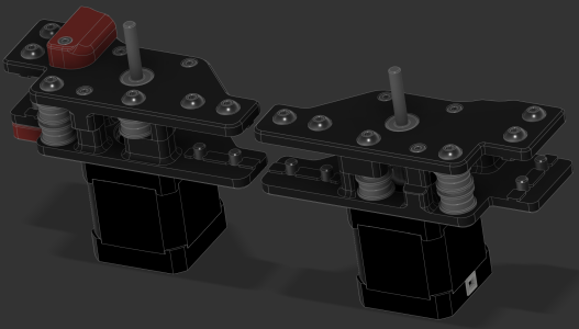

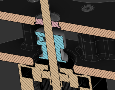

I put this together after noticing some minor skew on the shafts on my 2.4. A top-mounted F695 bearing adds extra support to the shaft of some LDO 2504(S55) long shaft stepper motors, which could minorly reduce VFAs while printing.
I am still waiting on my steppers, but I wanted to share the mod in the meanwhile.
I've built out every version of the 2.4r2 and Trident AB drives, including support for @DustinSpeed's 9mm belt mod.
