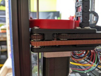

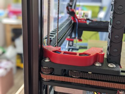

I used my Voron 2.4 now over a year pretty happily. A few weeks ago, I needed to replace my first XY-belt. I thought that was just nominal wear, but now, the changed belt had enough wear again to prevent moving to the 0,0 position, without missing steps.
The problem in detail, I also included pictures:
When moving to the front corner (0,0), the belt attached to the B motor will move up on the idler attached to the A motor mount. The increased resistance induced step losses in motor B. First I thought it was something similar to this forum post, but my problem is on the opposite site.
What's strange to me, that I hadn't that problem for a year and now it happened twice. The seconds "incident" might have happened, because I increased my belt tightening and therefore making the base problem even worse, but I have no idea how to fix it, except changing my belt every few weeks/months.
Does anyone know how to fix this, or has some ideas how to get to the root of the problem?
Thx in advance!

Yeah so it might be introduced from the front idlers. If it has a sight bend in it this can show up over the distance. Maybe look into RAMALA's idlers. These have two screws to make adjustments to help the belt run straight.
Posted the link. Something else I would look at it racking the Gantry to make sure it is super square.
Thx for the quick reply! I will try that. I squared the gantry yesterday, so that should be fine now.
Something else you might want to do is remove all the side panels, power off the printer and just sit behind or on the sides and move the toolhead around to see if you can find where the twist is coming from.

I have the exact same issue in the exact same place on a Trident. Did the replacement idlers resolve it for you?
I am fairly sure this is the cause of some very bad X axis artifacting I am getting
Didn't change them yet :DDDD I just turned the belt arround for now and printed the IDLErs for a future replacement
Same exact issue...replaced my belts twice...have you tried the new idlers by any chance yet? 😅
Are you absolutely sure that all the spacers are in place? That looks like the distance a spacer or two should fix. Or….a part printed just out of spec. Or it could sadly be myriad other issues, but just a couple more things to cross off the list.
