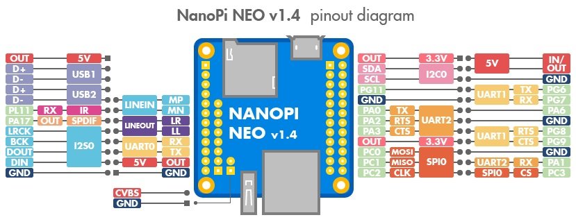

				Default W1 pin on Nano PI NEO
I enabled modules, and connected DS18B20 but still haven't 28-XXX... folder in /sys/bus/w1/devices. In README.sun8i-h3-overlays written that default port is PD14 but i can't find it on my board pinout.

	#!/bin/bash
sudo apt update
sudo apt upgrade -y
sudo apt install python-pip python3-pip python3-numpy python3-matplotlib libatlas-base-dev -y
pip3 install w1thermsensor numpy
sudo sed -i 's/usbhost2/usbhost2 w1-gpio/' /boot/armbianEnv.txt
echo 'param_w1_pin=PG11' | sudo tee -a /boot/armbianEnv.txt
echo 'param_w1_pin_int_pullup 1' | sudo tee -a /boot/armbianEnv.txt
sudo dtc -I dtb -O dts -f /boot/dtb/overlay/sun8i-h3-w1-gpio.dtbo -o /boot/dtb/overlay/sun8i-h3-w1-gpio.dts # convert dtbo to dts so you can nano/edit it
sudo sed -i 's/PD14/PG11/g' /boot/dtb/overlay/sun8i-h3-w1-gpio.dts
sudo dtc -I dts -O dtb -f /boot/dtb/overlay/sun8i-h3-w1-gpio.dts -o /boot/dtb/overlay/sun8i-h3-w1-gpio.dtbo
