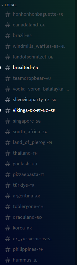

Hi Peter, if you're stuck, join the discord and pop your head into #brexited as well as possibly getting an answer here. We've had a dig and none of the regulars on discord that we are aware of are near you. We may be able to help you remotely if no-one pops up and is nearby.
Thank you. I will join the discord group but what is #brexited? Google is not much help! I am not surprised, East Angular (as Jade Goody would have it) is not at the forefront of technological innovation (other than cambridge of course). I am going to keep moving forward slowly but, statistically, time is not on my side. Not only do I need to learn how to construct a Voron, but I need to learn programming for a Raspberry Pi and how to use a serious CAD suite; so much to do and so little time :) . Thank God for retirement!
Please don't include me with the Brexiteers! The greatest act of national self harm since Suez! Now we are a small island off the west coast of Belgium! Seriously though, what has this got to do with building (or trying to build) a Voron?
It's the name of local channel on official VORON Discord, people from local community decided on the name when channel was created. It does not represent political views of people involved. Most are sad it happened.
Just to add to what Sanity said, many of the regional channel names are quite...tongue in cheek. But they are all selected by the members of the channel. Please don't think of it as any body else poking fun at you, just your regional folks poking a little fun at themselves
