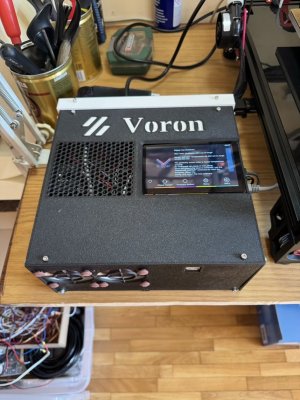

The electronics do not weigh enough to be of significant effect but my first few months of ownership of this machine was filled with weekly flips because the wiring was all wrong and broke. That is why I went full out on this drastic solution.
Yes, there are so many wires and they need to be kept well organized and firm. Aparts the classic cable ties, there are in the market different kind of ingenuous products that makes the job much easier and clean.

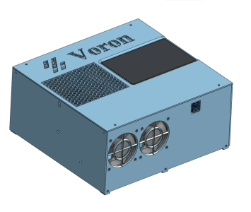

Yes the footprint right now is too large and I am designing it to be an upright box the width of the power supply. It has not got any connectors yet (unfortunately), but it might in the future. That would make life even easier still.
An upright box would be much better and compact. Keep us updated!

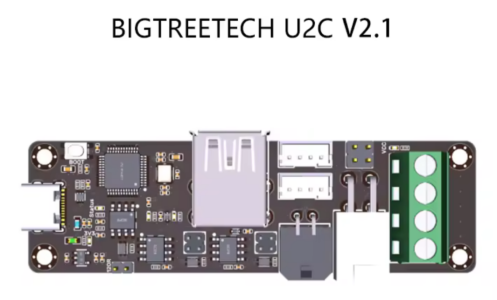

The U2C board does add wiring and with that comes questions and thinking about how to position them and route those wires efficiently. Next time I will probably like to be without those things.
Yes, and an extra communication layer (USB) is very bad. Something that I also want to avoid, but I'm wondering if this is a limitation of the Octopus rather than the CANBus boards:
Seems that the USB adapter is needed in any case, but stupid question: can't we just move it in the electronic bay and fix at least the wires issue?
