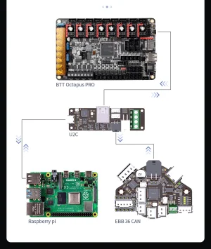

Choice of canboard I again cannot help I am afraid. All I can say is that next time I do a canbus machine I will probably use the octopus again and utilise the onboard. Simply for ease of use and compact controler.
You means Octopus Pro + EBB, right? From what I saw, even the lowest Mellow Fly is onboard driver. The Pro suppports 2240, a version that I've never taken care of until NoGuru joined the thread and
talked about it.
Can you confirm your EBB required a mod in order to fit your SB? This does not seem required with Mellow.
The U2C board does add wiring and with that comes questions and thinking about how to position them and route those wires efficiently. Next time I will probably like to be without those things.
Yes, and an extra communication layer (USB) is very bad. Something that I also want to avoid, but I'm wondering if this is a limitation of the Octopus rather than the CANBus boards:
Seems that the USB adapter is needed in any case, but stupid question: can't we just move it in the electronic bay and fix at least the wires issue?
