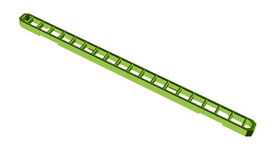

I’m using two in my 2.4/350, and honestly, it could use a third one coming from the front. Please don’t get me wrong! Two is absolutely plenty! You can see just fine! I just want a little more brightness because it’s just a bit easier to see everything. I would not put a 4th one along the back, just because you will look into it constantly. I’ve got three builds in progress (two Tridents and 2.4) and all will be using three daylight sticks. I made some simple clip-on shades for the Daylight sticks that I think work pretty well. I dropped them on GitHub if you are interested: https://github.com/Dfdye/Voron_Mods/blob/main/Daylight_and_matchstick_shades/Shade Body V0.1.stl

Thanks for sharing.
I might go for three and just adjust the PWM power if it gets to bright.

I’ve got mine on the spare heater output on my controller board just to make sure that the current draw isn’t too high. If you have one, that may be a good option.
