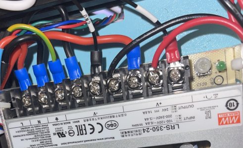

So I am using a BTT SKR E3 V3 motherboard I’m not sure If have everything wired correctly. My hot and fan and my part cooling fan or not turning on. I’m not sure if I wired the power from the PCB board correctly.
The two wires in the picture with the white shrink wrap on them, are the power and the ground from the PCB board. Are they in the correct spot?
That looks correct - I'd say check continuity on the wires from the toolhead to the pub to check for any wiring issues - also double check you're connecting the fan wires to the named pin on the fan ports, the negative ( - ) ones , like PC6 or PC7
