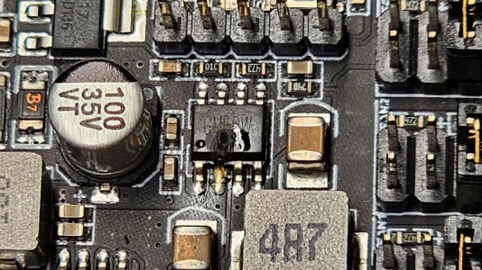

Hi all, good the little evening blunder when starting a new Voron ....
I slammed a component on my Manta M8P board I think it's a voltage regulator.
To replace it is not a problem but I must have the reference.
Could someone send me a picture of this little IC?
The start-up is complete until the test of the fans ....
After Checking to run a 12V fan on 24 it is the card that swallows ....

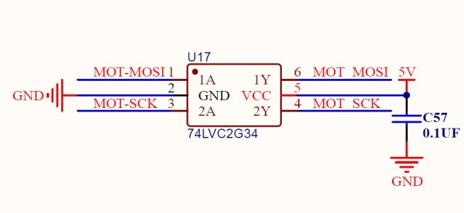

Go to GitHub bigtreetech mp8 hardware and there you find the schematic of your board with parts..

I didn't think of that. the only problem is that the component number is located below ... And my Voron works even damaged I just have my fans working at 100%.
I think it's the RY8336 step-down but I want to be sure first.
If you have a manta m8p can you just take a picture for me? I will change it once received.
I think I fried it following a recovered fan and not having the right voltage....

And much better in the same GitHub you can find the part number in the ....SCH pdf.
I dont know if its too late.. the chip is designated U17. U can see in the Hardware folder from the BTT github https://github.com/bigtreetech/Manta-M8P is a pdf named "BIGTREETECH MANTA M8P V1.0-SIZE-top". If you zoom in all is visible. I found it in the electronic schematic. I attach a picture. I hope it helps.

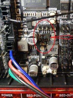

I have the exact same issue on my V1.0. It was working fine in my Trident and only removed because I was going to use it in a v2.4 since I went with a SB2040 and was able to use just an M5P instead. Anyways, I don't recall having anything hit the board so don't think it was a physical issue.
If the inductor below the IC goes to pin 3 then possibly U19 (RY8336 step-down regulator)... I'm only guessing as the boards doesn't have many 8 pin IC's and there's an RY8336 in the schematic...
Check the schematic in the datasheet, pins 4 & 9* ground, pin 1 supply, there's a cap between pins 1 & 3... try trace the track to confirm these.... *9 is probably metal base?
As I said, just guessing but it worth a shot, I assume it's Version 1.0/1.1 of the Manta 8?

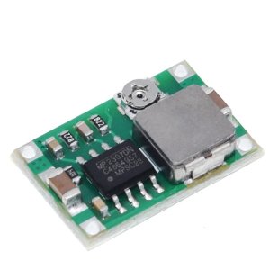

Big thanks for pointing out the component! I had the exact same issue while testing a shorted fan and it also blew in the same manner in my board, I contacted BigTreeTech but they were completely useless though this post helped me fix it ! The below might be useful for someone else so here's what I did. This chip is used for the 12V step down. I looked at the datasheet and found it it's very similar to other synchronous step down in sop8 format, so I used a hot station to replace it with the chip on the very common step down component below you can get from ebay/etc and voila! everything works again again and the voltage measured with the multimeter is exactly 12v.
