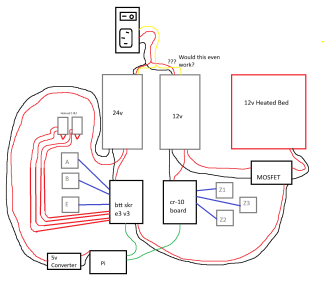

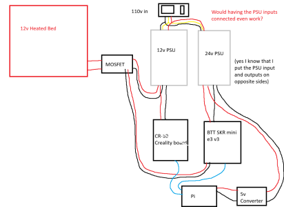

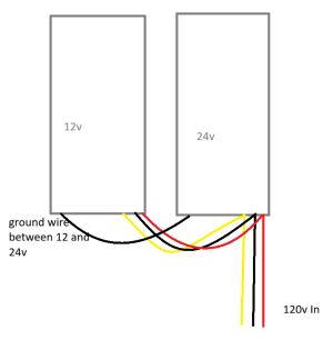

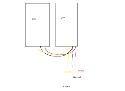

I am building a custom CoreXY and I need some help with PSU wiring. I would like to have a dual PSU setup, with one 12v and another 24v. The easy but inconvenient way to do this would be to have 2 power cables (one for each PSU). I would like to wire both to one input/cable, and I do not know how to do that. I have attached 3 (poorly drawn) diagrams that show how to wire it and how everything should connect. One is a more complex diagram, the next one is a simplified one, and the last one shows how I would assume it should be wired.
My setup includes a 12v heated bed, a 12v (cr-10) mainboard, a Pi powered by a 5v converter, a 24v btt skr mini e3v3, a MOSFET with a 12v input controlled by the skr mini, and 2 24v hotends (I didn't show fans).
Is my wiring correct? Thanks in advance.
