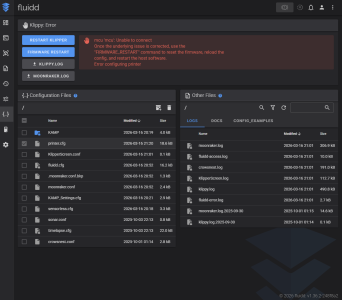

Hi all,
It has been long time since I flashed my firmware and I finally done it. However, I all my pritner config settings and files in the process.
I followed the same instrucion in building the new klipper and fluid webui and I cannot get it to wrong and I keep getting the same generic error message.
I have attached printer config for you.
Hope you can help.

your main MCU serial has some erroneous repetition in it.
serial: /dev/serial/by-id//dev/serial/by-id/usb-Klipper_stm32f446xx_480021000E50535556323420-if00
should just be
serial: /dev/serial/by-id/usb-Klipper_stm32f446xx_480021000E50535556323420-if00
