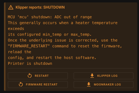

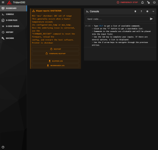

I finally got my LDO Nitehawk installed but I am facing two problems where I cannot under why so I am thinking either there is something wrong with the boardoard I have done something wrong.
1. I keep getting the error regarding "ADC out fo range" I thought it was relating to the thermistor because I had to conver the connector from 2.54mm to a 2.00 JST connector.
I have attached the photo and klipper log for reference.
2. There is no JST connection for the neopixel but according to the guide it should be in the SB toolhead pins. To be honest problem no.1 is more important. :p
Thank you all in advance and have a ncie day.

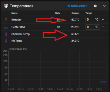

it's the thermistor, your extruder and chamber temp are both reporting around -56C, which is probably below the configured min_temp. you either have a wrong / bad connection, or the wrong thermistor type defined for them (both?)
Very interesting. Is there anyway to disable the thermistor to check if it is a hardware or software issue?
You can (and probably should) remove, or comment out the chamber_temp for now so that you can troubleshoot the extruder thermistor in isolation. but you can't disable that one.

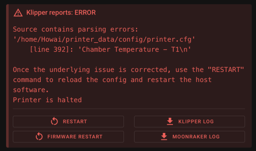

Ok so fair I managed to squash some bugs but I am now I am a stand still because I dont know what Klipper is trying to tell me. please help (T_T).
Unfortunately the clipper log is too big to attach but I have attached the printer config which the error is referring to.

So fair I squashed a another bug but at the moment Klipper is stuck on the this error message which I have no idea what it is referring to. photo and error log attached.

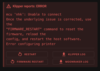

It's saying it can't talk to the nighthawk. Either the serial id is incorrect, or the board is not currently present and accounted for. Rechecking ls /dev/serial/by-id/* should give you a pretty good idea which

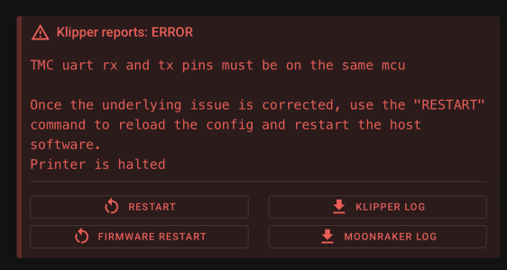

Great thanks! now I am back with the original issue which I have attached the photo and log

That one is saying Klipper can't see the required thermistor.
Long time no hear from! Thanks for the suggestion. I know thermistor is plugs but I am not sure if the arrange wiring is important. I have changed the min temp to -250 and I was able to get a reading both chamber and hot end thermsitor seems to have issues. I am starting to think that the issue is with the board.

Polarity doesn't matter on thermistors. A couple of thoughts because those vlaues are definitely not right. Are the thermistors defined with the correct model? Can you try a different port?
