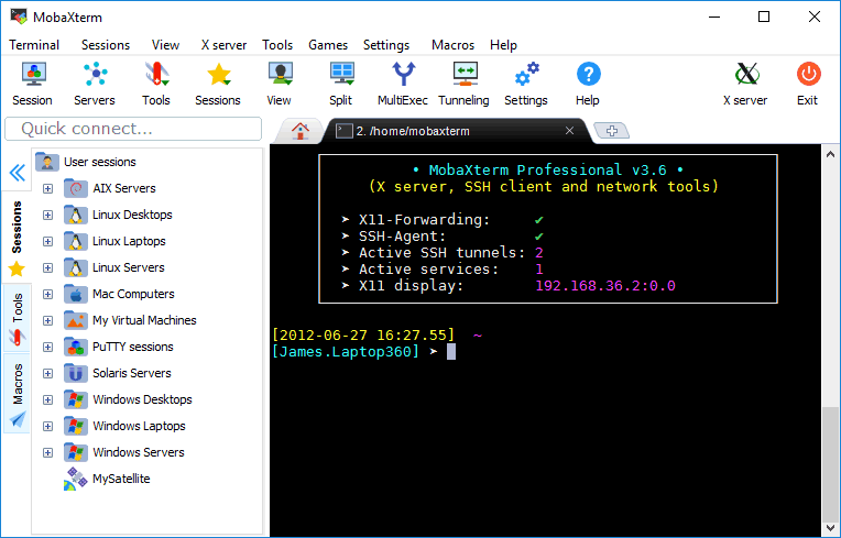

You will need an SSH client. I'm using MobaXterm for SSH, use your favourite.
