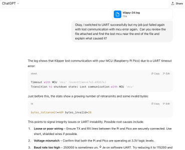

I removed the USB cable entirely and switched to UART between SKR PICO and RASPI4B. Got 90% through a benchy and then had a lost communication with MCU error. Chat GPT suggested changing the baud rate - and Klipper docs say specifically DO NOT change the baud rate. Either way, it definitely is not because of the USB cable.
