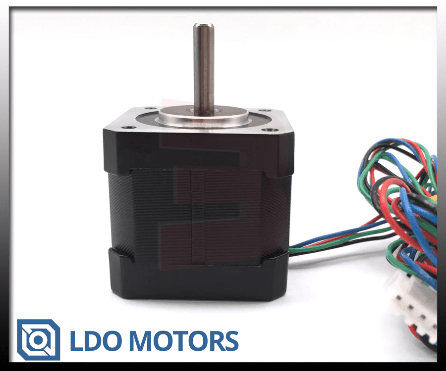

LDO Trident 300 kit seems to be using this

LDO Kit uses
LDO-42STH48-2004MAH(VRN)

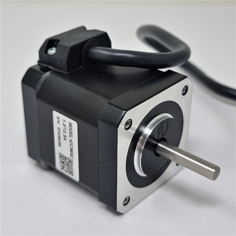

and I have a local option of
Nema 17 Stepper Motor (42CM06) - Leadshine
datasheet https://drive.google.com/file/d/1ZYB--n2jkllkwKzu9xZOFc1S586YdXY8/view
Question:
1. Can I use the local 42CM06 instead of recommended 17HS19-2004S as my AB motors on Voron Trident 300 build

17HS19-2004S is a part number and is not generally transferable between manufacturers. The NEMA standard is just "17" and defines the dimension of the face of the motor and says nothing about performance. of the length of the motor, just where the bolt holes are.
I've been looking at the motors supplies with different kits and the specs are similar but not the same. Basically for the 2004 motor, you want a NEMA-17 that is rated for about 2 amps and the other is a one amp motor and then there is a maximum length. You are OK as long as it physically fits.
The part numbers work on the Stepper Online website. They have very detailed specs. Look them up and then buy anything that is "close". You can click the blue part number and get more details and then from there even more detail. They are a good and well-known brand. I don't know where you are but they ship from warehouses all over the world.
2. Why does LDO kit use 0.9 step size motor for AB instead of configurator recommended 1.8 is it because its much finer step size ?
If you half-step a 1.9 degree motor you get the same effect as full-stepping a 0.8 degree motor. and we know all the drivers will micro-step to much less them half steps
Assume a 20 tooth pully and 2 mm belt pitch. This means the belt moves 40mm per motor revolution. So 400 steps per rev means 0.1mm per step. Smaller microsteps mean even less per step. So either step size combined with the driver's microstepping can get move then enough resolution.
That said, full steps move in exactly the specified number of degrees because the full step size is determined by the mechanical design of the motor. But half steps and 1/16th steps are not 100% perfect and depend on the driver getting the voltage ratios exactly right and the motor having exactly the same number of turns on each coil. But 3D printing is not exact and we should not worry about that last 0.001 mm. But resolution is the not the only thing to care about, Torque and speed matter too.
