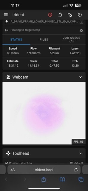

I am having a genuine infuriating issue. I just added an OV5640 wide-angle camera to my Trident that I got from DFH. Got it mounted and I can finally see my whole bed, but it seems when the chamber temps start to rise the camera flickers to a point I cannot see anything. I’ve restarted the Pi as well as Webcamd and tried different encoders in Mainsail to no change. Just trying to see if it’s the heat, my camera, or even the LEDs in my enclosure that’s to cause. Has anyone seen this?? B6EB087D-E851-44AB-AA93-4ECDF7D481E7.jpeg
I had mounted two cameras of this type on my Voron 2.4. As soon as I started heating they started flickering, getting violet pictures and finally failed. When printer was cold everything worked fine.
I exchanged the cameras with C920.
That’s exactly what is happening! Ugh… no real good camera solution for a trident. The C920 is too big and interferes with the SB during movements. Glad I’m not the only one though. Thank you!

Can it be enclosed in a manner that allows to pipe outside air into it? I guess that the camera does not like the heat.
Talking about a box with ducts for air intake and exaust.
