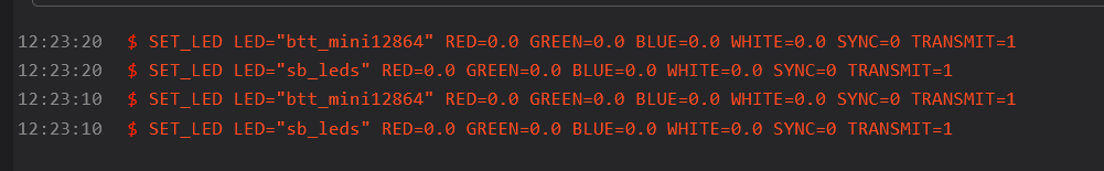

So this is a bit of a odd one that i have been struggling with for a while and for the life of me i cant find the root cause.
My setup is a Voron 2.4.
Running klipper with fluidd and mainsail on a rpi5 ( had a rpi4 before, same behavior ).
Using KIUHA to install ( also tried manually ).
So when i turn on the printer the SBs status light and nozzle light turn on and the mini Display as well.
Then thy just turn off.
(video included with log files, can be found her. But i think you get how the LEDs turn off
And this message gets spammed in the console:
There is no place in any files i have this setup including "SYNC" and "TRANSMIT".
To make things more odd, a clean installation with stock out of the box config file will do the same thing.
I have also tried switching between the rpi4 and rpi5 with fresh installations, manual installations etc but the result is the same.
And again to make this even more odd, sometimes it works! The LEDs are staying on.
And sometimes thy turn off after a while and if i turn then on again thy will stay on.
As you might imagen i am "thinking" i have gone down a logical route to trying to cross my "T" etc but there is something i am missing.
If anyone has any suggestions please let me know!
Thanks
