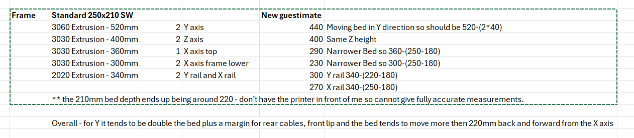

May I check please?
What sizes of extrusion and rails would I need for a Switchwire with a 150x150mm bed? (Ask twice cut once!)
What is the new location of the Z extrusion on the 6030 base extrusions?
Thanks All.
It's been pointed out to me that a 180x180mm is available from Prusa and that's going to be easier to get than 150x150.
So if you could help by calculating the sizes based on the 180x180 bed I'd appreciate it.

Back of fag packet calcs so take it with a pinch of salt.
To be honest, if you are procuring everything new for the build then look CoreXY - same bed will have a much smaller footprint. Other option is to drop a smaller bed in a standard SW frame - will still boost performance on the Y axis and then everything is standard sizing (i.e rails)
2.4 & Trident will scale down to 200x200 and you simply drop in a 180mm bed.
Are you looking 180mm simply to save cash or smaller printer size?
With the below measurements you will be custom rail sizes for X and Y and standard 300mm for Z
