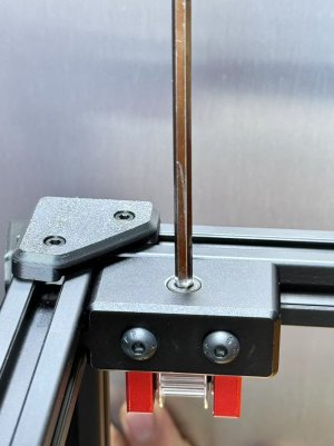

I recently found a Voron 2.4 aluminum alloy kit. In the next few days, I will assemble it step by step to see how it is different from other aluminum alloy kits. I am looking forward to it giving me a different experience.

The kit I bought is from stek,The experience feels good,This kit is slightly different from the original.
First, the z belt drive was originally a combination of two parts, but now it is processed in one piece. The concentricity of the three bearing holes is better and the installation is easier.
Second, the x_carriage part was originally a combination of two parts, but now it is processed in one piece, and it has been optimized, weighing only 65 grams.
Third, the Z Bearing Block Bottom part has been slightly changed. The original ring shape of the fixing screw position has been changed to a cone shape, and it is matched with a fish ball, which makes the joint rotation smoother.
Fourth, the XY Joint part has been shelled and reduced in weight. It is only 56 grams to reduce the weight of the XY arm and reduce the inertia during high-speed printing.
Fifth, the manufacturer also gave a sheet metal material rack, which was polished and very beautiful.
Sixth, the tensioning screws of the Z Idler parts have also been optimized. The original position was a bit inconvenient to operate. After the position was changed, it is much more convenient to adjust the Z-axis belt.
