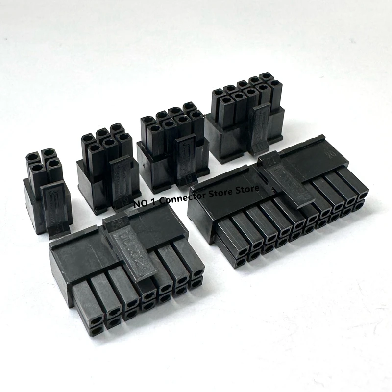

In the end i got tired of this as i needed to do it every now and then.
Further research found that the umbilicals are shorter than spec (probably down to cost saving) by about 10-20mm.
I went full bore and got crimps and connectors and made up my own umbilical in the end and its been rock solid for morth a year and half.

Damn really? Because when I was trying to fix one of the connectors that was giving me intermittent cutoffs I noticed it was just broken within the cable. Can you hit me up with some parts. What type of connectors did you get and where?
