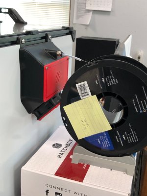

Yeah! i've been noticing that. On my last print (a print that took 3 times longer for the problem to happen) I actually increased my measured rotational distance by 20mm to keep the filament from feeding in excess (I'm sure you know how that worked out).
I have an idea that might work for measuring both. I'll try it later when I'm not going to bed.
I've been thinking about just using an Arduino, stepper driver, and some limit switch with a very light touch. It would just maintain a slack loop. Once the loop gets to some minimum length, it would feed out 10 or 20 cm of filament. The feed rate wouldn't matter much as long as it was faster than maximum extruder feed rate. I just haven't worked out the mechanics of the limit switch arrangement. This would be kind of crude and not integrated into the printer's control system. Maybe Klipper could do it instead of an Arduino, but I wouldn't know where to begin doing that.

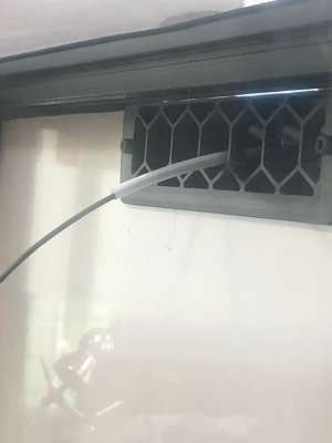

I've been getting pretty good results by sitting the spool on a stand with bearings. This is placed just outside the enclosure where the PTFE tubing enters. I'm just using a 15cm length of tubing. Its a straight shot into the enclosure. All in all, it takes very little force to pull filament. If I start doing more TPU projects, I'd like to something using a 2nd motor.

Thanks for that information. I think I can draw some inspiration from a dancer arrangement.
I removed all but a stub of tubing to minimize friction of TPU in the tube. The problem with that is the Y axis does a big part of pulling filament. Worse case would be pulling the entire travel distance of the Y axis (350mm) at 80mm/sec. This would require a lot of slack to be available or pulling off the spool pretty fast. I’m thinking that putting the long tube back in would be best for a dancer.

I like that Idea, but I have space constraints. I'll use it, but i'm going to keep working on mine also.
My new problem is that it snags(more like, jumbles up before the feed tube into the hotend) within the CW2. Not sure what to do at this point...
