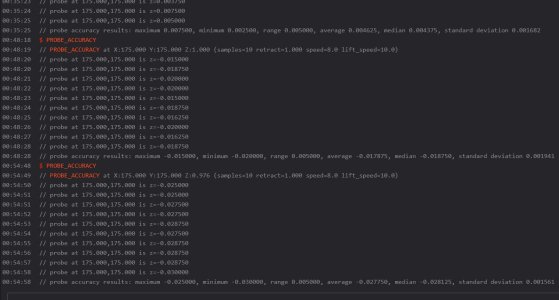

I connected the Probe to the Probe Port, and it looked good at first trys. The accuracy was below the voron requirements. Sensorless Homeing of X and Y worked, and Z worked as well with the Probe. Also QGL worked.
So as a next step I tried to test the probe, when the printer is heated up to ABS Temperatures. I preheated the Hotend to 240 Degree Celsius and the Bed to 100 Celsius. And then give it 30 Minutes to heatsoak. Than I tried the Accuracy test again. And it was not good.
probe accuracy results: maximum 6.607500, minimum -0.527500, range 7.135000, average 0.641000, median 0.142500, standard deviation 2.008853
