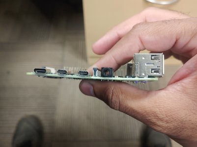

I received my pi today. Looks like its not damaged. But it looks bended at the center. Is it originally like this or I have received a defective one? I have attached image here
I mean, PCB's should be flat.
The tracers on a PI are pretty durable and I don't think that will cause you any issues.
