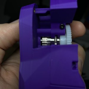

I'm building a Mini Stealthburner from my LDO v0.2 kit. The right-most position for the primary gear is still not enough to be centered with the filament path. The set screw doesn't allow to move the primary gear the last 0.2-0.3 mm closer to the T50 gear (original Bondtech BMG part), because the flat part of the shaft is too short. Is it a tolerance thing, so I may have better luck ordering a second one or is it an issue with my printed parts?
![IMG_5985.jpeg IMG_5985.jpeg](https://forum.vorondesign.com/data/attachments/4/4360-6796efc4c483de2de46174144ec051ba.jpg)
The shaft is 27.56 mm long in total and the shorter part behind the plastic gear was already ~3 mm, so there was no need to sand it down.
