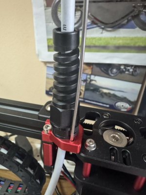

Forgot to mention also that I already relocated the electronics and removed those daft cable chains. Months of grief with those and having to lay your printer on its back everytime you need to get to those electronics gets boring very fast, so seperate controlbox on an umbilical and the base will stay open.

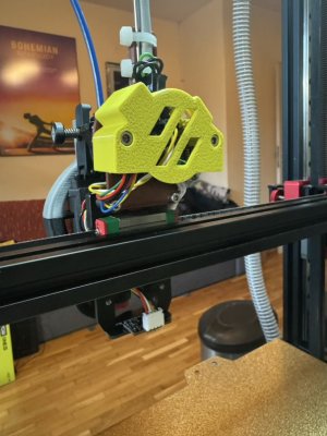

I found that one of the mgn9 rails for the x acis deformed at the point where the fixing screws are located. When I took it of it has a ridge along its back which makes it sit not level in the length of the 2020 profile. This comes as no surprise really, as the buying guide leads you to shitty cheap rails from unidentifyable origin and no guarantee for any quality or grade.
Purchased an original Hiwin mgn15 and I already have a carriage with Z1 and gradeP so will just be using one rail for the toolhead.
Nearly finished milling a small adapter plate from mgn9 to mgn15.

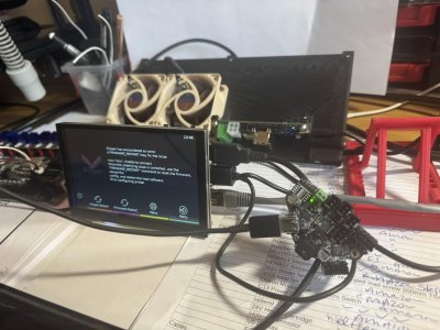

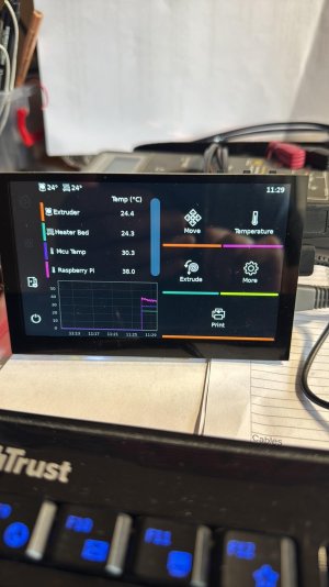

So I finally had time to pick this up again. I have now build a new mainsail / klipper, got KlipperScreen to work again and flashed my MCU with a new firmware. Used Esoterical's guide to canbus to flash the EBB36 and to update my U2C. I believe it is all working because all the suggested returns are correct sofar. I have to say this Esoterical guide is near perfect. It just could do with a little more lower level advise for people like me who have never coded anything before :censored: but he deserves a KoFi for sure so will look at this when I am done.
Now what is left to do is to tidy up the wiring on the control box side. Then terminate all the tool head wiring to the can bus board. Then to take measurements and to rewrite the config files. Find some new homing macros for the Cartographer and carefully start testing.
Been a rollercoaster because I am totally not up to speed with this firmware flashing and it scared the hell out of me, but I feel good about finally having tackled it.

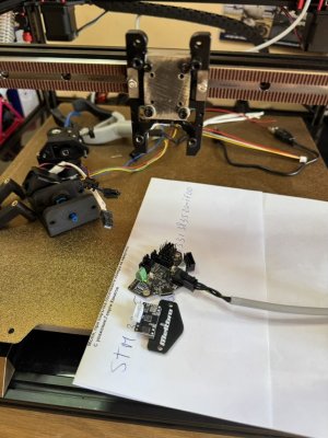

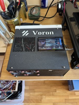

Finally had some time again to continue a bit with this project. I have now finished the control box again and everything works as expected.

Now the only things left to do ( as if ONLY means something small and easy 😬) are the toolhead wiring to canbus and the config mods to incorporate the canbus, cartographer and switchless homing allround.
See how I feel later about crimping them horrible connectors on short pieces of wires you can almost not get to with those big crimping pliers 🫩

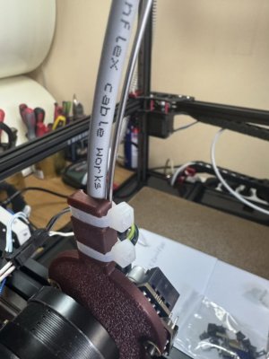

Finally I made some preperations by mounting the toolhead parts, adjusting the cartograper height and route the cables. Next is those horrible steckers 🤮

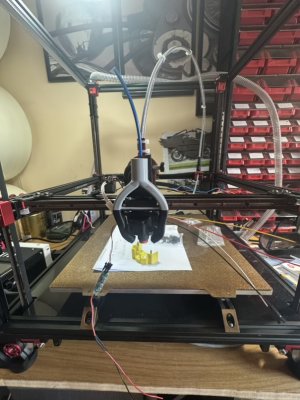

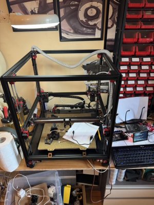

From a build table full of parts it got to this 😍
All the parts installed and all wires found a route and a little nest to sit in.
Now its time to start it up again and see how far klipper gets with its new canbus and cartographer. If all is well I will get some errors in mainsail, if not its time to cry…..again 😂🤣

Hmmmm, canbus is working and hotend works. HE fan does not work so possibly a wrong pin, bad connection or…..
Strangely the bed also does not work so I am hoping its just a silly oversight with the SSR or something.

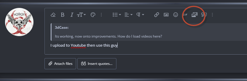

I upload to Youtube then use this guy

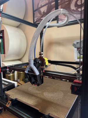

You have gone into an area that I have yet to travel with CPAP. I am curious to see how you like it and pros and cons. I don't print with PLA very much so I probably don't "need" it but since its something I haven't done yet I may end up doing it for fun.
It is actually nothing special, just a frame mounted mini turbine and a very flexible lightweight hose. If you have something flimsey to print it blows it away 😂🤣
I am running it not higher then 60 at the moment but it responds really fast so its ideal for bridging and overhangs. It starts at the drop of a hat and is up to speed immediately.
When I do some more tuning I will speed the machine up gradually, then it will get handy.
