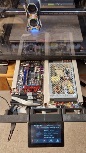

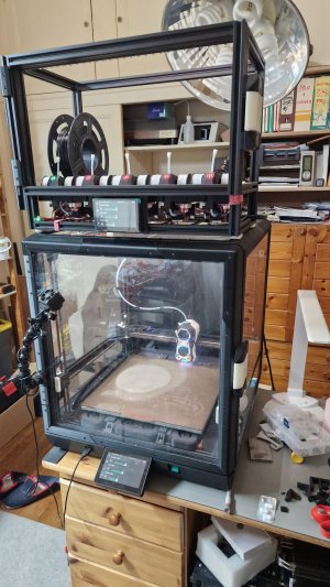

No need for the doom mod for dual panels, fridge door, HV/LV separation and rounded corners !
The main benefit is rigidity.
This is a regular V2.4 with fridge door, dual panels and rounded corners.

I love the pull out drawer for the electronics bay. Did you find a mod for that, or design it yourself?
It is an unpublished mod.
It would be a nightmare : the rails for the drawer are repurposed salvaged kitchen drawers, and the dual panels mounts are screwed to the frame, meaning that for removing one panel, at least 3 sides must be removed because of the pyramidal corners ! Total 6 panels and dozens of screws. Nobody will make this. Moreover all dimensions depend on the the acryl panels and foam seals. Made with what I found locally. The fridge door is made of V slot extrusions I had by hand (as well as the Box Turtle). Also some machined parts.
100% custom, 0% reproductible, and 0% tinkerer friendly !
Forgot to say : discovered the hard way that ABS and ASA parts don't last long in a toasty printer. Since then all parts were replaced with a CNC kit, and the toolhead was reprinted in PET-CF and annealed. Before I retrofitted the machine, had to reprint everything 3 times, ABS and ASA. Needless to say the V0.2 was CNC'd too, and the Micron built with annealed PET-CF. (because of heat creep)
