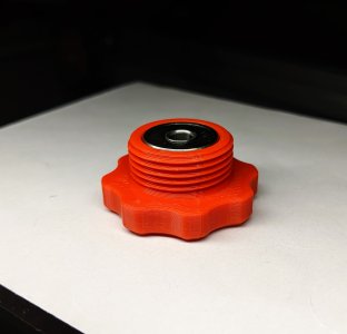

Colour selection is a bit basic, their red leans more towards orange. The silver can be a bit fickle and does absorb moisture, the others can be left open for years and still print fine.
It's a classical ABS: it's shiny, smells when printed and it loves a warm chamber, the hotter the better. Printed in the right environment the part have a great strength and durability. The filament diameter is extremely consistent across the entire length of the spool (measured within +- 0,005mm).
