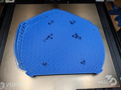

The photo below contains two of the three jams I’ve experienced in that time span. The first print failed on a very similar feature (internal bridge), but on a much much much smaller print. I’ve printed some pretty long (> 12 hour) parts on this printer with the same brand of filament, and similar settings, without issues although this is the first large “fairly normal polygon with big parallel faces” that I’ve tried to print.

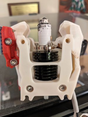

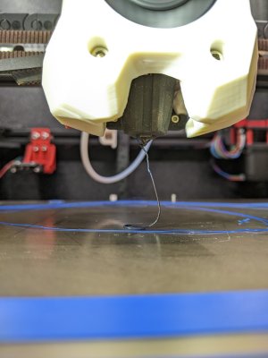

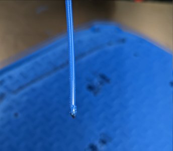

For all three jams, I was able to release the extruder latch and pull the filament out of the heat brake. There was a blob at the bottom of the filament, which would be too big to get through the orifice in the heat brake (it’s a very snug fit on a Rapido). I suspect this is from sitting touching the heat brake for the remaining hour and 50 minutes in the print after the jam occurred. Note to self: install a filament run-out sensor…
There’s also always been a little bit of filament left in the hot end. The photo below is what came out after manually pushing it out with a metal rod I got with my i3 clone.
After the first clog on the small print, I reset and the print went off without a hitch. I didn’t think about it again until the top print above failed. I decided to swap nozzles just to be safe and bumped my extruder temp up from 230 to 240.
It looks like I might have been under extruding a tad on the third print and/or I need to tune pressure advance. The OG nozzle was plated brass, and I had recently tuned, so if it was starting to wear out then some minor under extrusion with a new/fresh nozzle makes sense.

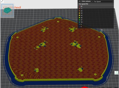

Here’s what the slicer shows as happening on this layer. I am not showing the full layer so you can see it ends with the internal bridge on the lower left. There are a handful of retractions, but they’re not very frequent. There is no retraction at the end of the internal bridge before the travel to the start of the next layer.
The next layer starts perimeters first in the lower right hand corner. I don’t see evidence of the perimeters starting, so odds are the jam is happening between the two layers.
I have the slicer set to print nearly all features at the same speed, other than overhangs. This is potential correlation #1
I have the fan set to 40% with no cooling for the first 10 layers. However, for overhangs it’s going to 80%. This is potential correlation #2

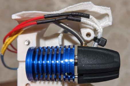

What my Rapido looked like after ~670 hours:
That little mishap is most likely the culprit. I did like the Rapido for a while but for me the heatbreak was too sensitive.
I started using bambu labs hotends since they are cheap and perform very well.

I'll pull the hot end apart this weekend and ream out the cold side of the heat break more. I did order a v2 Rapdio, so I I might even bring some heat to this party. I'll be sure to post pictures of the process and outcome for those interested.
Update!
After cleaning out the hot end and reaming it out some, there was plenty of space where the old crimp was. I actually had to close the orifice back up some because the fit in the heat sync is... very tight.
To be safe, I lowered speed and bumped temperature with PETG and:
I removed the hot end while it still clogged this time and discovered that the clog was happening lower in the hot end. There is another small divot further down that tube, which might be contributing to the clog, but getting to it would require a 2mm diameter metal rod and I don't have one of those in stock.
In the meantime, the Rapido 2 showed up. I installed it with my v1 printhead prints and am up and running and clog free (so far). Wire routing is a bit tighter, but it fit with some minor persuasion. It looks like there's a v2 version of the printhead, but it would want me to disassemble the hot end. It looks like the wiring would wind up with similar bends anyway. I'll have to investigate whether or not the overall hot end length or nozzle location changed... If part cooling is unaffected, I'm tempted to leave it alone.
