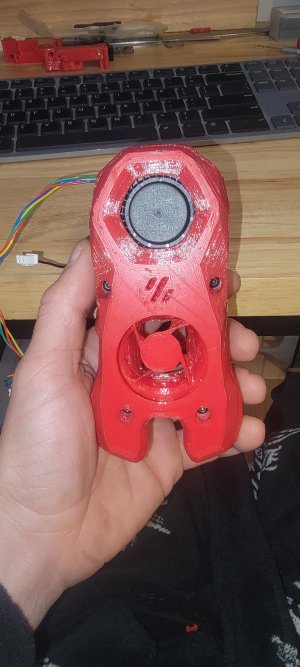

Thank you all for all your help in advance, I have been trying to get this fitted for over 30+ hours over the last 2.5 days, and I am at my end, I'm over it, so now I ask the pro's for help!

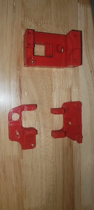

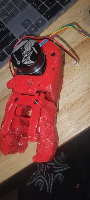

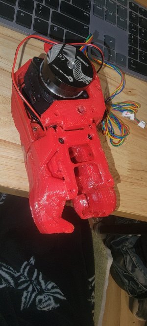

The stealthburner assembly I have currently, and the parts I have printed out and am currently using in a dry fit before install. Please ignore the heat sets if they are in the wrong spots due to me assembling this backwards, but I wanted to do this to avoid having to rip it all apart, to in turn have to put it back together because I needed to print a part, which happened twice when installin gmy rapido UHF V2.
So, the parts I have printed out for my stealthburner so far are:
- All LGX Lite parts from github here: 3 parts total https://github.com/Eytecz/LGX_Lite_...unt/tree/main/LGX_Lite_Stealthburner_ERCF/STL
- Both the Front for UHF and front for SB downloaded from here: 2 parts total https://mods.vorondesign.com/details/XN1NolgVYYBu1HNnxqC7Fg
And the Rear Mounting plate for the Rapido (which are the same everywhere)
The problem I am in desperate need of help on, is how the hell do I get the stealthburner to mount to my ender 5 sotck x carriage??? I have downloaded and printed just about every mount out there that I can find, and either I am too stupid (high possibility here), or the mounts are not for what they say they are.
Can anybody please point me in the right direction for a mount and/or mounting system that will allow me to mount this damn thing to my x-carriage?
Thank you so much in advance for any help or advice you can give. I have beem messing with this for 2 straight days 12+ hours each day, while I'm home healing from an injury. So if anybody has anything good, bad, or anything in between, please let me know. I am about to just say F&%# IT!!!! I am so over this, and to think I have spent 30+ hours trying to get this mounted is just ridiculous!
Sorry to be the bearer of bad news, but the short answer is: as is, you won't.
Long answer:
The Stealthburner toolhead is supposed to be installed on the carriage of a linear rail, installed on the aluminum extrusion of the gantry. More than that, it was also originally designed to be driven by a CoreXY kinematic system, while the Ender 5 Plus have a purely Cartesian kinematic system.
There are some ways to solve that:
  1. you can further mod your Ender 5 to make it a CoreXY 3D printer, the most mature of the alternatives out there is the Mercury One (that's what I did with my own Ender 5, but I have the release version, it was updated later);
  2. or you can print a mod that allows the Stealthburner to be installed on the stock E5 carriage. Google showed me this one, but I'm sure there are others out there.
