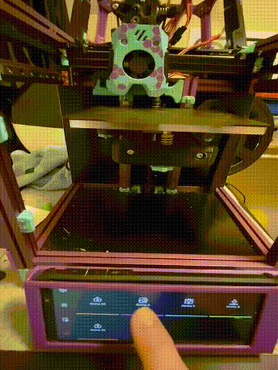

I'll see if I can post of GIF or something of it later, but:
Unless I start with the X position close to the limit switch already, when homing X my 0.1 will move the toolhead in the positive X direction for about 10-20 mm, then give up and give me the error "No trigger on x after full movement".
So, I'm thinking it ends the last print and then somehow starts off with bad coordinates, so it stops at what it thinks is the limit but hasn't actually reached the endstop switch. Part of my reasoning is that it seems to work like it should when I start from a fresh Firmware Restart.
Could it be something in the PRINT_END code? Or maybe a rapid acceleration right at the end that makes a loose belt slip?

What is your position_max on the x?
Also maybe something with microstepping or rotation _distance? Could be that the printer things it went 120mm when it went only half or something like that. 0.9 vs 1.8 degree motors.
Best to share your printer.cfg at least the x stepper part.
Is this sensor less homing or endstop switch?
Need to see your printer config.
Endstop switch. This only recently started happening (a week or 2 ago). I hadn't changed anything in my printer.cfg at the time. I upped my X amps a little after it started happening, but that didn't help. I think it may have started after I got a "MCU 'mcu' shutdown: Timer too close".
