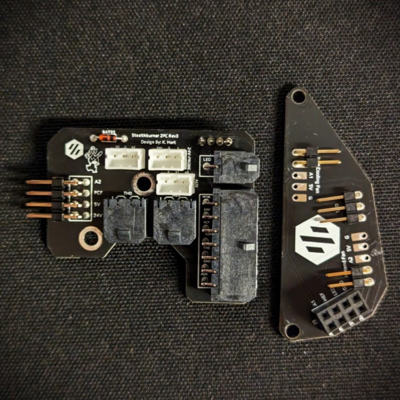

Issue: Z endstop will not trigger when a metal object is close.
I have an Omron TL-Q5MC2 2M inductive probe (stock part taken from my other Fysetc 2.4 build):
A 2 piece Hartk stealthburner head:
kb-3d.com
I've confirmed that the probe is getting 24V, ground is correct and the signal wire teases out to the mainboard via ohm meter.
Plugged into PA3 (Z endstop) on a Spider 2.3. (though I have not wired up a simple switch to see if that's working. The X and Y end stops work fine, so I don't think that's the problem).
The probe will turn the light off when a metal tool is close and the Signal >> Ground will flip states, but only by 0.6 volts.
The probe wiring is:
Brown >> 24V
Black >> Signal
Blue >> Ground
Printer is a Switchwire conversion.
relevant code section in printer.cfg
Brown >> 24V
Black >> Signal
Blue >> Ground
[probe]
pin: ^PA3
x_offset: 0
y_offset: 25.0
z_offset: 0
speed: 10.0
samples: 3
samples_result: average
sample_retract_dist: 3.0
samples_tolerance: 0.006
samples_tolerance_retries: 3
