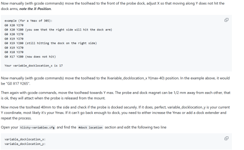

Hi guys,
I was wondering if someone would shed some light on setting up the variables for the Klicky probe dock. The part in the manual regarding this is somehow rocketscience to me.
I have the dock on the left side of the printer. I can manually pickup and dock the probe by jogging the toolhead. I have found that the position X:0 and Y:345 is where this interaction takes place. However if i use these values the docking process fails. The toolhead wants to go out of bounds on X ( the macro does a -30 somewhere) .
I don't understand this part of the manual, and i believe this is why my variables are wrong. Perhaps someone can help me explain this bit.
![2023-06-03 17_29_40-Klicky-Probe_Printers_Voron_v1.8_v2.4_Legacy_Trident at main · jlas1_Klick...png 2023-06-03 17_29_40-Klicky-Probe_Printers_Voron_v1.8_v2.4_Legacy_Trident at main · jlas1_Klick...png](https://forum.vorondesign.com/data/attachments/2/2568-7263f9cdcad71553a77d8ed6f5cc291e.jpg)
