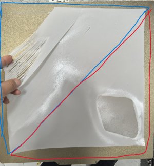

This printer has been running for over a year and hasn't been able to print for many hours. Recently, the first layer of printing has suddenly stopped. The z-offset and mesh bed have been recalibrated, and every time they print, the top left corner splits, while the bottom right corner is always good. I don't know why, but the z-offset and mesh bed have been calibrated several times。400X400X400

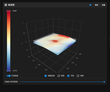

The deviation is quite high -0.003679 to -0.162429 as against mine at 0.005000 to -0.015000 ...
That's almost a full layer at 0.2, what do you get if the bed is at 50° C before bed meshing?

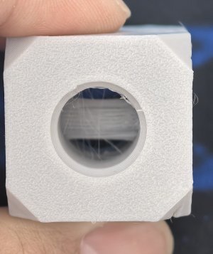

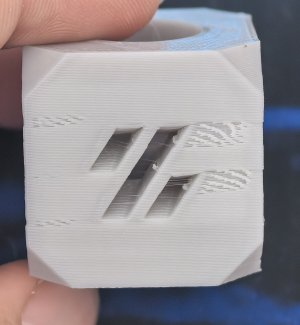

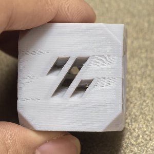

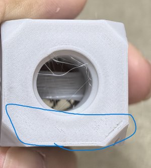

The 50 ° mesh bed is leveled for printing, but there is still a fork in the first layer of printing in the upper left corner
So it corrects quite a bit when warmed up?
The lower left and lower right are showing profile, what is their bases like (side touching bed)?

Judging from first and last images, pressure advance needs work (I think it's pressure advance)...

Sorry for the typo. It should be the top left corner (2) and bottom right corner (1). Only the bottom of the bottom right corner (1) can be used, and the bottom of the top left corner (2) cannot be used (the top left and bottom right corners indicate the position of the printing board). The leveling is done using TAP, with a layer height of 0.2mm and a hot bed thickness of approximately 8.5mm. The hot bed is processed by CNC

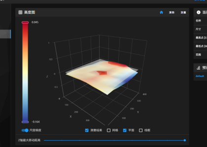

Best to visualize the map as it does indeed look like the bed needs work...
With bed cold, go to HEIGHTMAP and run CALIBRATE...
Set Scale z-max to the middle, take a screenshot and post it...
Might as well heat bed to 40° C, run CALIBRATE again, take another screenshot and post it...
How is bed attached to frame? (just checking if bed is under any strain)... Is the frame 20mm extrusions?
You could try loosening the screws securing the bed just in case you are introducing strain if frame is off...
Could try another calibrate and see if any improvements...
I'm almost certain the bed is not ground flat but as WC Fields said when caught reading the bible by a reporter, "I'm looking for loop-holes" ;)

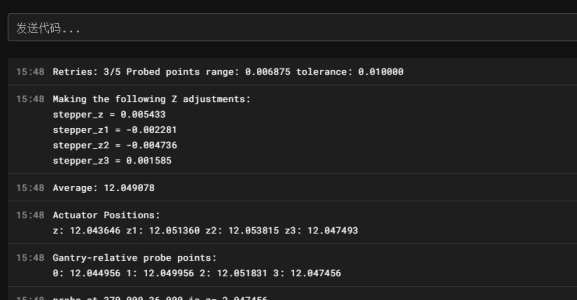

I have sent an error of 0.00687 for the leveling of the TAP gantry with 40 ° and 50 ° mesh bed detection. The installation of the hot bed is also based on VORON's official installation, and the extruder used is a process extruder, which is also official
What do you mean by setting Scale z-max as the middle?

Ok, my point is that on a large slab of aluminium heated bed, the expansion during heating will make it bigger. This means that the four screws that holds the bed down will change their position relative to eachother. I believe the instructions also mention this, so to help keep the bed stress free, they tell you to not tighten all corners equally. Just one corner needs to be fully tight, the other three just enough to keep the bed down on the frame.
Maybe do a bed mesh when cold and take screenshots of the graphics showing it, then heat the bed to lets say 40 degrees and do it again. Now heat it to 80 degrees and again do a bedmesh and look at the graphics again. If you do ABS then heat to maybe 100 or 110 again and do the same.
If you see a clear correlation between heat and the warping of the bed, you can say that the corners could be too tight.
Let it cool down, slightly undo three of the four corners and repeat the check up to your previous temperature. Look for improvements if any.

There are some improvements, but not many
