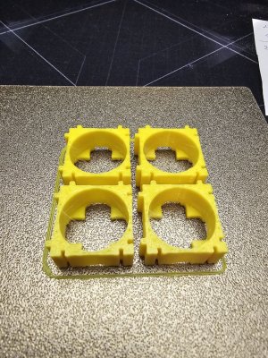

First filament that I was printing was outside for I think 2 years, (PLA)
Last print was done with TPU 95A, (First time printing tpu, and first cube was disaster cause of to low gripping of extruder, but after some adjustments with screw inside extruder it works ok. )

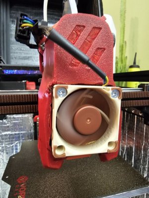

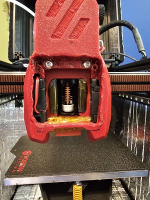

It's going to be placed in cold room, and I've had problems with printing abs without isolation, but now I'm having problems with heat creep, and now I'm waiting for noctua fan to replace small heatbreak fan, just to print something else, and change the printhead to accomodate bigger fan, and better airflow, cause now enclousure can get over 50C with no problem during prints. Heck even pla is now problematic cause of the to high temperatures, even with open lid and front doors the heatcreap is still there.
But after the insulation installed it was printing the abs visually really well but the bond between the layers is now a problem.
(BTW I just like to tinker with printer :) )

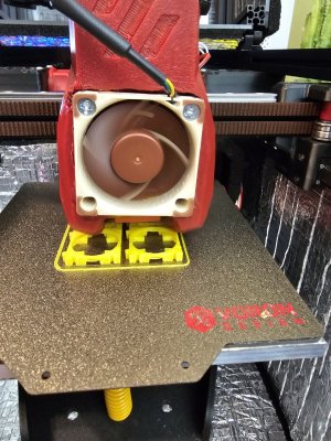

After cutting out some of the plastic and slapping the noctua fan on the hotend it works, pla is printing with no problem, now time to tune things up :D (cause the prints that I wanted to do don't fit together)
But as fan is placed in front of the shroud the voron now don't close, when printhead is at frontal position, and even opens doors while going forward.
