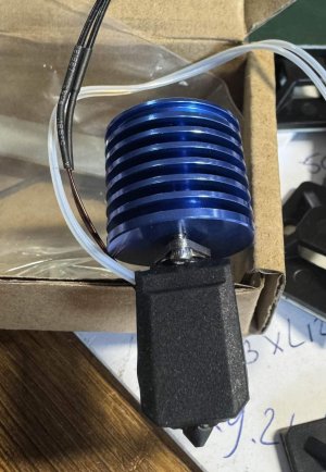

My formbot kit came today but its missing the printed parts because they come from China. strange it has a hotend which in the partnumber says V6-2.0 but I ordered a dragon HF. When you look online there are many dragon style hotends so I am not sure what I received now.
I've bought formbot kit with 3d printed parts and hf dragon, but on site they said that dragon hf and 3d printed parts are shipped from China, so I will see tomorrow what is inside the package from china :).
Cause in the main cartboard I've got the same hot end as You, and I hope that I've got spare ;), not main hotend :D
Yep I've got my hands on 3d printed parts and there is phateus high flow :). But custom inspection has looked inside of the package, cause the cutouts have different parts in them, and some are even unpopulated, and rest is just shoved inside in the biggest cutout.
