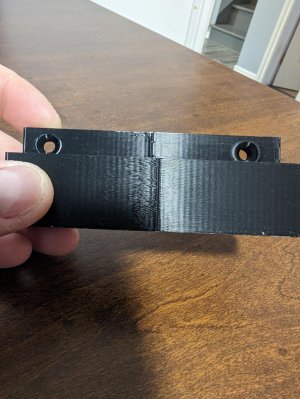

Hi,
I have a voron 2.4 since 10 month. Now i have a vertical line appear in the middle of my print. What is the problem?
Thanks
That is the seam. You should be able to see this in the slicer. What slicer and seam settings are you using?
