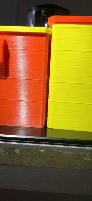

Question Need help for Z print quality problem
Bral
Print 2 models, The textures that protrude from the surface are not at the same height, What is the problem? How to fix it?
Hello, this looks like something is blocking Z motion. Did you lubricate Z rails? Did you put foam on panels to prevent Z belts from rubbing on side panels? Are all 4 Z belts tensionerd evenly? Are Z modules assembled correctly?
Can you freely move gantry up and down or is it binding somewhere?
I have the same problem... did you manage to solve it?
resolved... need to correctly configure the belt tension
