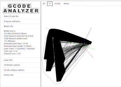

Im attaching the generated G code Slice made with Orca. What are these butchering cross straight line that ruin my L shaped bracket?
It suppose to be just L shaped print. all these crossing lines throughout are not desired

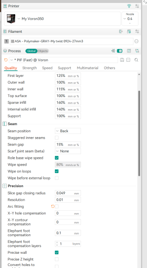

Found the sollution , here it is if someone runs to the same problem. Arc Fitting Setting shoul dbe disabled for Voron printers i guess. Anyway it worked for me
