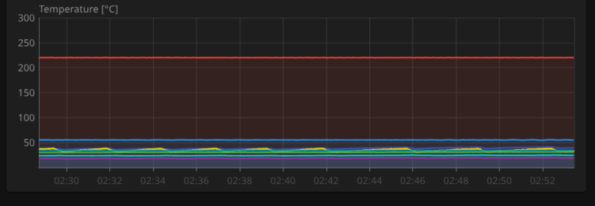

A couple of print failed with hotend temperature errors (something like hotend temp out of range) or Heater extruder not heating at expected rate...
One additional fail due to hotend temp over max when it wasn't.
Here is an image of the temps for the failed print:
As you can see the temps vary quite a bit, normally it's a straight line with little deviation...
I redid the pid tuning just in case... it had changed a little from previous values...
Basically, a few minutes into a print, temperature appears to fluctuate by 10° or more within a second or two (which is not actually possible).
At some point temps must drop below whatever the lower limit is set to so print job halts.
It looks like the heater or more likely (almost certainly), the sensor/thermistor is close to failing, so I ordered a replacement.

Printing a test Benchy, looking for fluctuations in temp which occur every now and again.
It temps drop below some minimum, print fails but so far it's still printing...
I'm capturing the screen for the graph to post (in case it fails).
The thing is, since the seven fails in a row, it has printed two print successfully but the temp are still fluctuating... see below.
Note drop at ~04:41, below 200 but it didn't stop...
Spoke too soon, it crashed with the usual error...
See the 'verify_heater' section in docs/Config_Reference.md
for the parameters that control this check.
At the end about 05:59 temps drop below 200 but this is less than first drop in image 1, where it didn't crash but now at this point it did?
I will know as soon as replacement arrives but it looking very likely to be the heater core (thermister/heater) as expected...

:mad: I was convinced it was the heater core on this occasion... I was mistaken.
While swapping out the heater core with the new one, I decided to test the cables again but this time tugging them slightly more aggressively. While doing this, I noticed one cable was longer than the other, which was strange, I cut them to the exact same length. It was obvious now, the cable must have become lose or broken away from the connector as with a slightly more aggressive tug, the cable came free while the heatshrink remained attached/crimped.
Tugging on the cables during my testing didn't expose the loose wire as the heatshrink offered enough resistance to overcome my slight tugging. In hindsight I should have pulled a little more aggressively but, these tiny connectors and wires are fragile, not to mention difficult to crimp... I didn't want to break them.
Graph of second test print below (first test was identical)...
It should be noted, a loose or broken or loose wire will produce similar graphs to those attached in previous posts.
A broken or loose wire, whether in the actual core housing or at the connector end, is still a broken/loose wire.
Basically, if you get fluctuations similar to those previously posted and you have no broken wiring, it's probably a heat-core issue.
