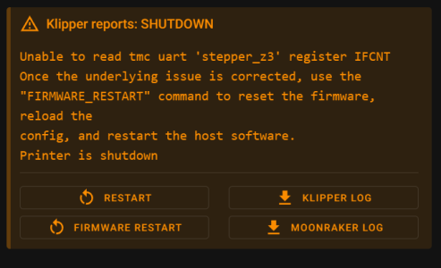

I'm working on my first build for a Voron 2.4 and I cant seem to get past this error:
Unable to read tmc uart 'stepper_z3' register IFCNT.

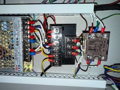

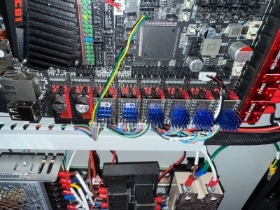

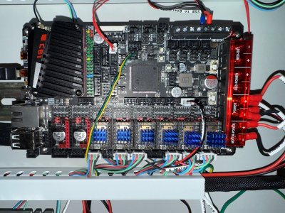

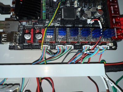

I have checked my wiring, all looks to be correct. Jumpers are in the correct location. Every time I try and home the print head, or move it in any direction the above error is thrown and I am at a loss as to what it could be.
Does anyone know what this may be cause by? I cant find the issue and I've searched high and low through multiple forums, discord groups and reddit. I've attached my printer.cfg file, klipper log and images of my wiring and jumper locations

You have got to be freaking kidding me.
I need to drink more. Almost 6 hours and it was staring me in the face the whole time. Thanks for letting me know. I do appreciate it.
