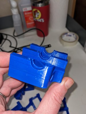

Trying to print the parts for a 2.4 R2. I must have run through a spool of ABS trying to get the quality OK, but when I print at 40% infill, I get a lot of gaps or underextruded sections. If I drop infill to 30% or 35% its better - almost resolved. I did find that Hatchbox ABS has less problems than the Esun ABS I started with.
Details:
Ender 3 v2, direct drive all metal hot end, side mounted spool with bearings on the rollers. I tuned this using Teaching Tech's procedures
Prusa Slicer
Bed at 100, nozzle at 250
Hatchbox ABS
Using the Voron PIF print settings
Any suggestions on how to fix this? Is 30% infill strong enough?
Thanks all

I started with Hatchbox Blue and and E3 v2. I love Hatchbox. The creality pizza box chamber had my parts warped though. As you can see, It didn't come out great, but I still think my 2.4 looks great. I told myself that I'd reprint once I built the printer, but I'm ok with things mostly. I redo stuff here and there, maybe.
What's your layer height? Issues are more visible to me at .4mm I use .2.

Layer height is .2mm. Nozzle is .4
have you tried slowing the print down a bit? Maybe that'll help...

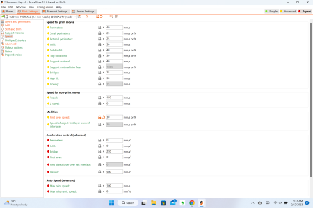

The first thing that I played around with after temperature was speed, any speed between 30 - 60 gave me the same results. I went to the Prusa Slicer defaults for ABS and for the latest print I slowed it down from 50 to 40 for perimeters and bumped the infill from 35% to 40%.
Here's a screen shot of my speed screen:
