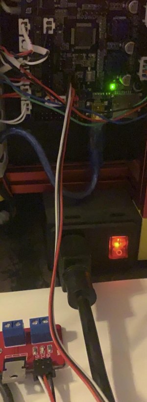

I am installing a Nevermore Micro V4 on a V0.1 with BTT SKR Mini E3 V2.0 and wondering if there any way to connect and control the fan via software as FAN 0 and FAN 1 are obviously taken?
- Klipper Expander is a popular option.
- LDO's new Picobilical board would also be a good choice too.
- A canbus toolhead board would free up several slots on your mainboard
alternatively you could just wire the nevermore directly to the 24v PSU and have it always-on.

So I used the neopixel port. There's no power or nevermore connected at the moment as I just moved that one to V2.1944 for its 24V fans. Need to rewire it for 12V on my 2nd nevermore.

I just installed neopixel strips last week so that port is not available, do you think I can use any other pin or does it need to be a specific one?

I should preface this by saying I would like to control mine via software also, though for now, I just wired up a manual switch. If I'm printing ABS, I just turn it on manually. If I'm printing PLA or PETG I usually leave it off. It's not fancy and is a little ugly (switch is just in-line with the power wire over to the Nevermore) but it works.

I have a Macro that toggles the fan on or off... Then there's the fan in the "Misc" section of Mainsail that allows you to select the speed.
Then it's in my "presets" for ABS/ASA to turn on when I'm heat soaking etc
