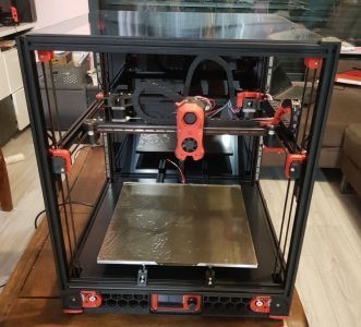

Last August we decided to make a mod to mount our spool tank on Voron 2.4 and we bought a Formbot kit with printed parts. As we have already revo hotend in stock for voron we decided to use it.
Assembly and Klipper set-up took some times but were easy.

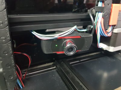

Webcam holder with low profile:

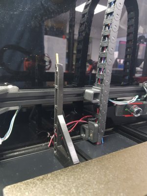

Enclosure thermistor holder:

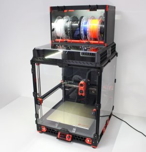

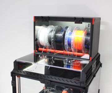

Right after that we designed the mod for mounting the Spool Tank :
