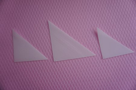

![z-offset-troubles-scaled.JPG z-offset-troubles-scaled.JPG](https://forum.vorondesign.com/data/attachments/3/3430-e97f410bc58805f4378a7048bdcf5eef.jpg)
I finished building my trident about a week ago and since then I'm trying to trouble shoot this z-offset fuckery. The z-offset seems to change after every print. The picture shows three 1st layer prints that were done in succession with the same exact settings(slicer and klipper) after I calibrated the my z offset.Anyone wants to take pity on me and help me resolve this madness inducing issue I'm struggling with?
Things I checked/tried so far:
- tighten every screw about which it's not explicitly stated in the build doc not to thighten
- rechecked the probe position in the toolhead and made sure it sticks out 6mm out as stated in the documentation
-calibrated the z offset(using the method from the pinned comment in #voron_trident_questions from the voron discord) at different bed/nozzle temperatures and different bed heat soaking periods
